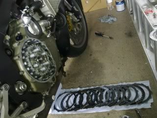

Postby 5parkyuk » Mon Mar 26, 2012 12:07 pm
NICKED FROM ANOTHER FORUM
Apparently this is a KNOWN fault . :shock: ,here is how you can upgrade.
To change your SP1 clutch plates to SP2 clutch plates, you'll need:
Qty 5, Clutch drive (friction plates), pn 22201-MAT-E00
Qty 1, Disk-A (outer friction plate), pn 22201-MAT-000
Qty 1, Disk-B (inner friction plate), pn 22202-MAT-000
Qty 1, Judder Spring, pn 22402-MAT-000
Qty 1, Judder Spring Seat, pn 22125-MAT-000
Disks A and B are identified by one tab colored green on the outer edge, and have dark speckles on the friction material.
Disk-B is the inner friction plate that has larger I.D. to clear the judder spring.
Disk-A is the outermost friction plate, and has its tabs installed on the shallow slots of the clutch basket.
The 6 steel drive plates are all the same on SP1 and SP2.
On an SP1, to replace friction disks, just order Qty 7, pn 22201-MAT-E00

Postby Sppete » Mon Mar 26, 2012 3:07 pm
Good find :clap: :thumbup:
Make sure you soak the new clutch plates in new engine oil overnight or it will slip.
I popped mine into ziplock bags because I couldn't find a pot big enough to put them all in at once, you don't have to use half as much oil that way either :P
