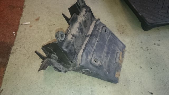

It just so happens I have a few NC23 spares kicking about, including a complete undertray, The rear end of which wasn't such a bad match widthways, so I decided to create a frankenstein using my old one.
Here's the cut tray
Heres the NC23 one after I hacked part of it off
And here it is after further cutting, fitting, cutting, fitting, cutting etc
Not a perfect match, but not bad and best of all its cost bugger all. I don't think many bar the purists would notice.

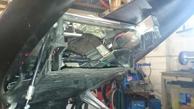

Spent about 3 hours plastic welding this morning in the freezing garage, this is the result:
Had to add the side 'wings' as these had previously been chopped off, it should keep the back end sealed from the elements now when on the bike, also filled up a couple of holes which had been drilled and added a plastic blanking plate behind the numberplate bracket as the NC23 tray was open to the elements here - a difficult area to work in so the welding isn't the best.
Just got to work on the visible welds to smooth them down a bit. Overall it seems very strong, before I made it I was thinking about additional bracing, but its not required since the plastic I added to the welds was from the old NC23 undertray, so it has all bonded together lovely.

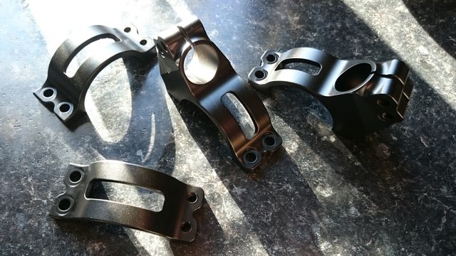

Clip-ons stripped, blasted and painted, just drying hanging above the rad in my lounge, gold anodised before (pic below), now they're satin black.
Also done the mirror mounts the same colour.

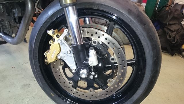

This week I've been doing the forks.
KTech springs, new Honda oil and dust seals, 5wt fork oil as per KTech with 115mm air gap, replaced the mangled adjuster screw with another damper rod assy.
Also painted the bottoms satin Black, the reason I didn't go with the original silver / grey was partly financial - would have had to buy the paint and 2k laquer, I like the black, plus it will be far easier to touch in if they get chipped again.

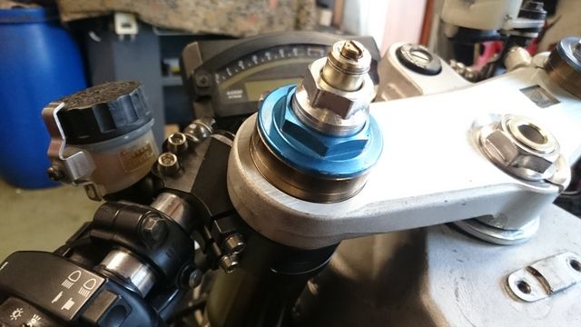

Just finished re-fitting with plated bolts etc (had the caliper bolts plated in black zinc as it looks better on the gold bodies I think):
New / replacement top cap and top adjuster, also re-fitted the black clipons, look so much better
There's a few marks on the fork outer tubes, from previous brake cable rubbing, but I'll have to live with these, think they're about £270 each from Honda. The replacement fork leg that I stripped the damper assy from had a decent enough looking outer, but on looking up the inside bore, there appeared to be a couple of little creases, so possibly a little bent or overtightened in the yokes.

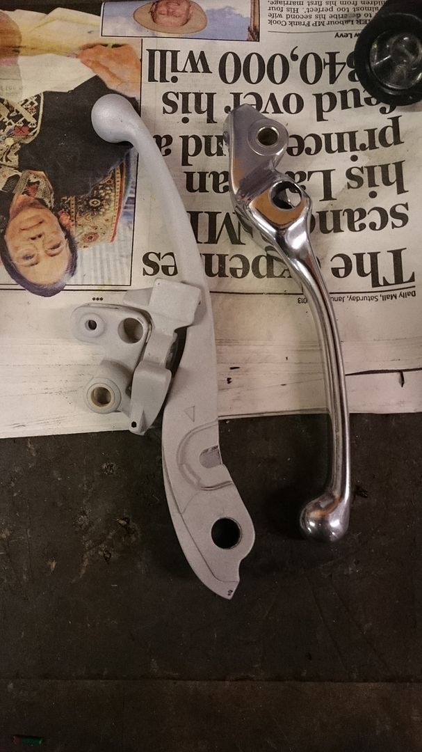

With the calipers and clutch re-fitted and bled it was time to tackle the levers
I thought it may have been some kind of plastic wrap, but no joy. Its more like a plasticised paint, so off they went into the blast cabinet, followed by a poloishing session. Post blast and one after polishing.
Turned out pretty well, they look oem again.
