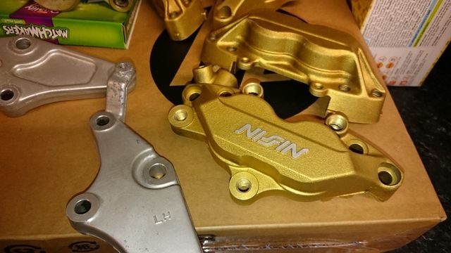

Dirty calipers
Clean calipers
I used wonder wheels on the rear, but didn't like using the acid, so thought i'd try something different on the fronts. I ended up soaking them in a bucket of hot water containing a dishwasher tablet, little bit of elbow grease and a fingernail scrubbing brush and they've come out a treat. Now rebuilt with polished pistons, ready to be refitted once the forks are done.
Unfortunately the caliper carrier brackets are corroded from the brake dust, so I'll have to blast them and paint.

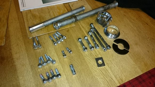

Got a load of bits back from my mate who's an electroplater, I cleaned everything up and polished the bolt heads etc. You can also see my DIY shock spacer thats been plated - runs out at 4.7mm.

Got the spring blasted and powder coated for a tenner and I gave all of the removable bits to my mate after cleaning and polishing to zinc plate

The bolts are just zinc, but I polish them first to give a really smooth finish, which the zinc matches.

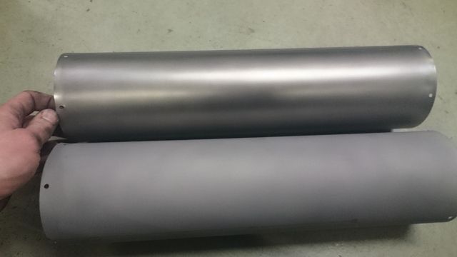

While I've been waiting for parts I thought I'd tackle the exhaust. You can see the end cans on the first page, the headers were also a little worse for wear, being slightly rusted and generally grubby.
I had various goes at stripping the colouring off the silencers with no result, then I realised that they're titanium and the colour is proper heat residue.
Off to the polishing machine, which stripped the colour off, but left an uneven finish, I just couldn't get a uniform shine, so I chucked them in the blasting cabinet and treated them to some crushed glass.
This made the finish uniform, but was too dul and dark for my liking, so I decided to scotchbrite them by hand. This was painfully slow, so I made a rig so I could fit them on the lathe, which sped things up enormously and didn't hurt my hands as much.
This is a pic of 1 can blasted and one polished:

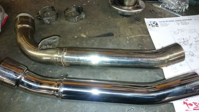

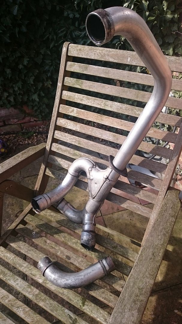

Onto the manifold / header.
I polished my NC30 headers and it was a laborious effort, but there is quite a bit on show with them, not so much on the SP.
For this I decided to give Pipe Gel a try as I'd never used it before.
It took a couple of applications and some elbow grease, but I got a decent result:
Autosol'd it all to give a decent finish and additionally polished the pipe which drops down next to the shock as this is visible
Also polished up the link pipes - before and after:
