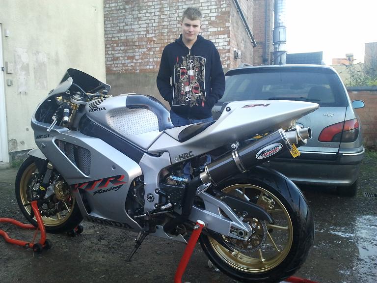

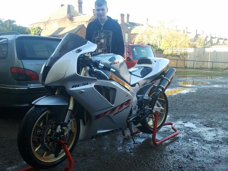

refitted the fronts and rear calipers and the new Radial master, reservoir and HRC rear reservoir kit. Front still feels a little spongy so i may need to have a short spin to stir them up a bit then re bleed, pretty sure there is still some air in the calipers somewhere. forgot to take close ups of caliper finish but im well pleased. Then i got my son to wash his inheritance as i keep telling him one day :lol:
next is the radial clutch lever and reservoir.

originals will go back on if required, and probably will be required. The real interest to me with the HRC kit is the ease of access to the reservoir compared to the stock item which is a PITA to get to with the aftermarket undertail and repositioned electronics. I will try to source some better tubing if it exists :thumbup:
